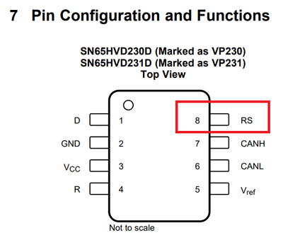

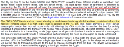

When you are using a chip and you face an issue you need to start with looking at its datasheet as you may find some answers there.
You are using SN65HVD230 transceiver: datasheet at this link: https://www.ti.com/lit/ds/symlink/sn65hvd230.pdf?ts=1703754810632&ref_url=https%253A%252F%252Fwww.google.fr%252F
Now, regarding your question about Rs pin. This is it: (look at the datasheet page 5)
This is the Rs pin description in the datasheet:

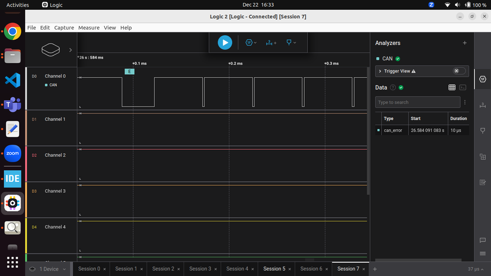

PranavGurav
NormalModeWaveform.pngThis is the waveforms I am getting by connecting logic analyser on the CAN_Tx pin.
First, provide more details about your bus connections. Did you connect a second node on the bus to communicate with your board?
Second, please provide your schematics.
And in next time, please use this feature to insert the code to enhance the readability of yours:
then:
Thank you.

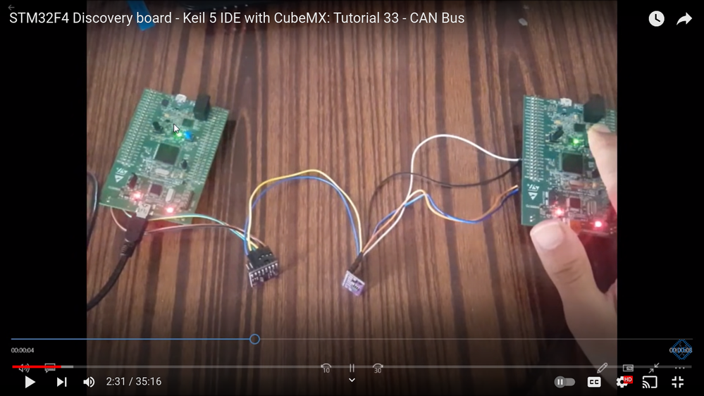

Yes, I tried connecting the second node but also got the same error. I have selected PB8 as CAN_Rx and PB9 as CAN_Tx. Also using sn65hvd230 transceiver which I believe has a 120 ohms terminating resistor.
PranavGurav
My doubt is why am i getting this error for normal mode while its working fine with Loopback mode.

PranavGurav
connection.pngI am referring this connection to set up the CAN bus
