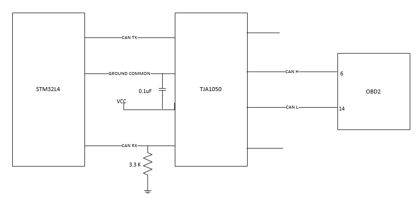

Hello Everyone,
I,am having a issue with my can node.
The communication bw two can nodes built on STM32L4 works perfectly fine. But that's just for testing purpose. I don't intend to use it that way.
When I introduce it to an existing CAN bus, TX stops. Node is able to read the messages on the bus.
Please let me know what all things i can try or i might be missing.
Hope someone has already been down this road and can help me out..

Hi TJ,
Have attached the block diagram of my setup.
The car if from FORD . and it has can bus.(have checked that with a scanner. and i am also able to read internal communication through the mentioned setup and the data makes sense too. )
Hope this clarifies the setup

I have no direct experience with OBD either, but I can help with CanBus.
In the time Quanta, Try Seg1 at 14, Seg2 at 1
I haven't used a L4 processor but on the F0 and F7, you must pull CanRx up if you don't have the transceiver.
So that is confusing to start. It may be a bus state from the vehicle.
Tell me you have a proper scope and analyzer.
Tell me it is not a $6 Ebay analyser.
Do you have the FORD OBD msg list ?
What msg are you trying to send ?
just to clarify, you have a nucleo board,
one Canbus is for the FORD and the other Canbus is to another Nucleo board.
between the Nucleo boards, you can Receive and Transmit, are you using transceivers ?
The Ford Canbus, you are using a transceiver, you can Receive but not Transmit.
is that where we are ?

I would try to connect CAN-GND of your Nucleo board / transceiver to pin 5 of the OBD connector, 'signal ground'.
‎2018-05-29 3:33 AM
Control pin S allows two operating modes to be selected: High-speed mode or Silent mode.
The high-speed mode is the normal operating mode and is selected by connecting pin S to ground.In the silent mode, the transmitter is disabled.
how did you connect pin 8 of the transceiver chip ?
‎2018-05-29 3:52 AM
That is Connected. Forgot to show in the diagram.
‎2018-05-29 3:55 AM
That is a
valuable
input.As of now its left floating. will connect it to ground.
‎2018-05-29 4:01 AM
floating is supposed to be default as ground...
‎2018-05-30 12:41 AM
Marsh.Nick
‌meyer.frank
‌Hi,
Thank you for helping me throughout the issue.
Finally the issue is resolved.
Hacked in 0 ohm resistor on the CAN H and CAN L lines with 120 ohm(termination) resistor b/w them.
