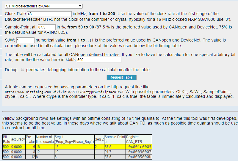

Probably some clock mismatch.
Check generated bitrate, and also the balance between TimeSeg1 and TimeSeg2.

I intend to generate 500K bit rate and m able to decode that on an analyser when testing the node separately and with other stm32L4 node.
On the other bus (obd2 can bus ) too, i am able to receive the messages from ecu but not transmit.
I say so as my transmitted msgs are not visible on analyzer but on the other hand the messages sent by obd2 port is received on analyer and stm32L4 node too.
Please let me know if this still can be a clock issue.
and I exactly don't know much about
TimeSeg1 and TimeSeg2. i just copied the configuration from ''
http://www.bittiming.can-wiki.info/#STMicro
''Have attached the picture of the same. Please suggest if any changes are required in this area.
