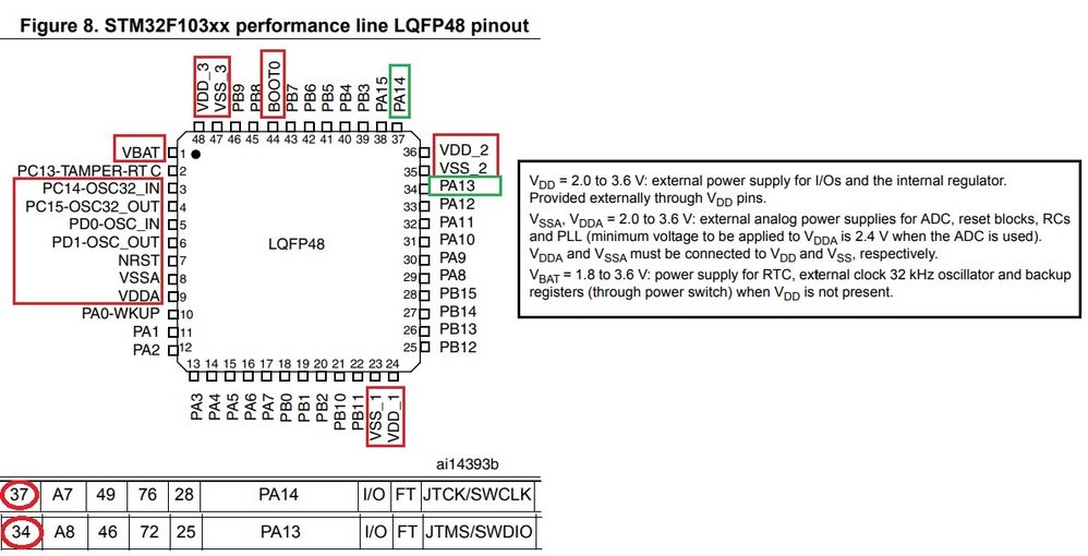

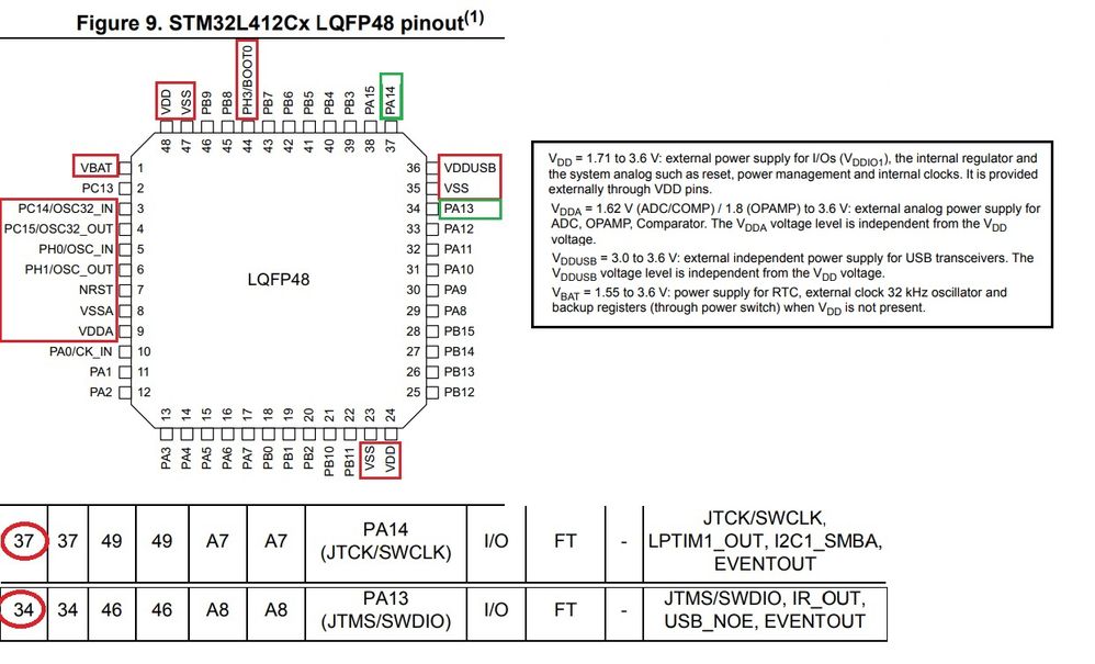

i replaced board mcu from stm32f103c8t6 to stm32l412cbt6.
now i cant connect board with swd port.
is stm32l412 not support swd port by default?
or do i need to change some schemetic for stm32l412?

2021-04-01 4:54 PM
here
Options
2021-04-04 9:51 PM
[solved]
use cubeIDE or cubeProgrammer
