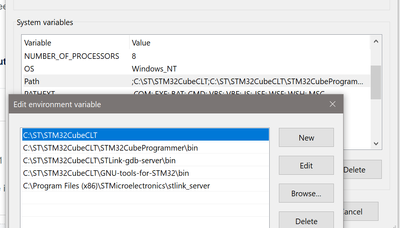

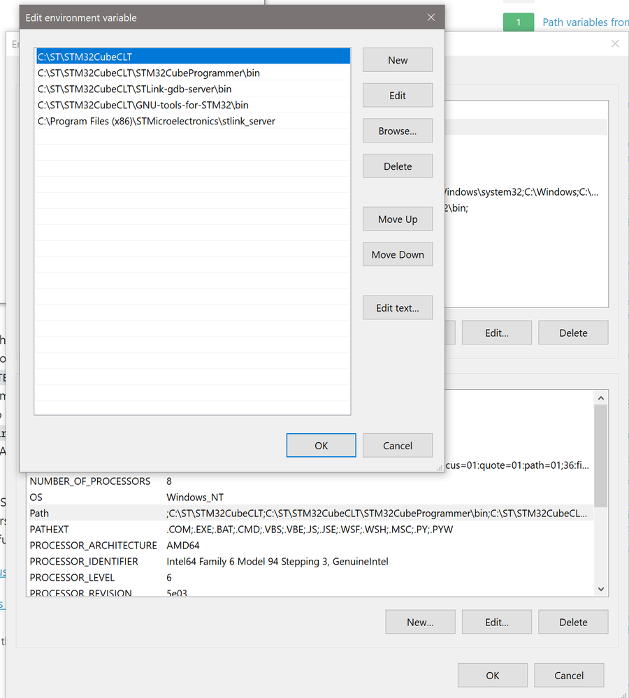

After I installed STM32CubeCLT v1.12.0 my system PATH variable has been wiped and now contains ONLY CubeCLT related paths, while all the rest are gone. This has made a bunch of installed software unusable and I don't have an old enough backup to restore the values from.

I just tested the latest CLT install - same result - it wiped my system PATH (although this time it was anticipated so I backed it up).

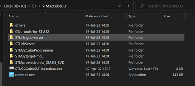

I have a Windows 10 Pro 22H2 x64 machine running build 19045.3208 when I install CubeCLT it erases the PATH variable after a successful install, so after it only CLT entries are present. This happened to me twice so far (as you can see from the posts above) for v1.12.0 and 1.12.1 on the same computer. I'm installing under C:\ST\STM32CubeCLT
