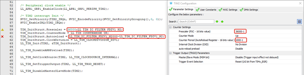

I'll just leave it here ...

Hello
Maslennikov.Konstant
After check, I reproduced this issue and raised it internally to CubeMx team for fix.
Thanks for bringing this to our attention.

This is lib for stm32f103c8t6
