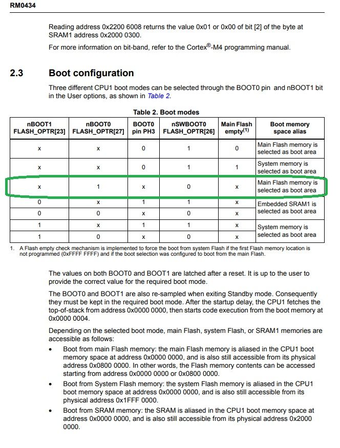

Perhaps there's a setting via the Option Bytes?

The JTAG/SWD works at a gate (flip-flop) level to access internal elements of the IC, via what was classically called scan-chains. The is unrelated to the USART, USB, SPI, I2C, CAN methods which are facilitated by code that is ROM'd into the product, providing software defined/controlled interfaces.
The BOOT state can be controlled via the Options Bytes in the STM32WB, see reference manual page shown in post above.
