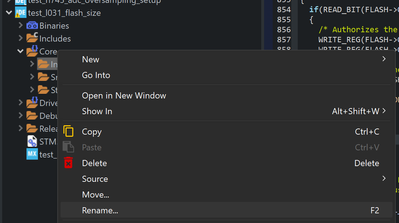

Why isn't the linked code able to be ran in MikroC?
Why can't you rename folders? STM32CubeIDE certainly doesn't have this restriction:

For renamed folders with STMCube, the problem is that I need to do a new project using "IOC" file , redo generating code and , after, copy saved "main.c"...
If not I have link problems.

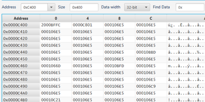

He you can see the "bin" file I have so vectors are OK but, anyway, it doesn't jump to 0xC800 (so here with last STM32CubeIde files)
Two possibilities, no effect.  I'm pretty sure there's something special about STM32L151RDT6
