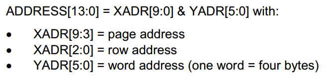

I've tried this function and can not work properly, seems the address param should be 16 bytes(4 words) aligned, but I can not get any indication that I should align the address by 4words.0690X00000609BbQAI.png
ADDRESS[13:0]should be ADDRESS[15:0] ,right?
