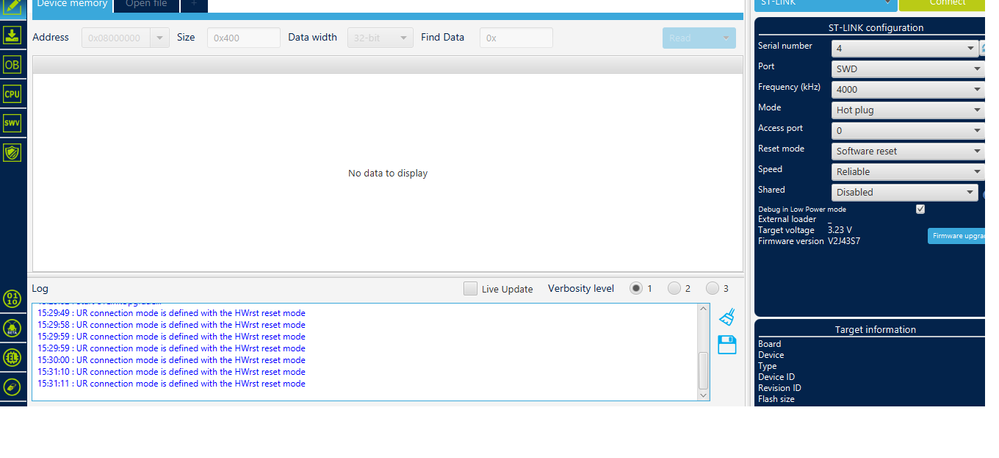

First we have to know, what the chip telling ...on connect.
THEN we can check, whats the problem with Keil with this chip...

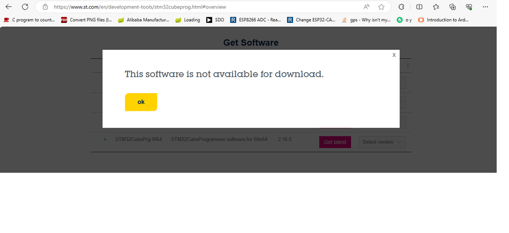

That's a different issue; see, eg,
https://community.st.com/t5/other-software/cant-download-any-software/m-p/662605#M1498
Puuuh...problem: could you try with a VPN ?  (Many have problems with download from STM last weeks.)
Here, STM32 Cube programmer is not available for download, if you have it's setup, can you share it with me, so that I can install and test it the way you are suggesting?
Which version...Win64 ?
Yes Win64
