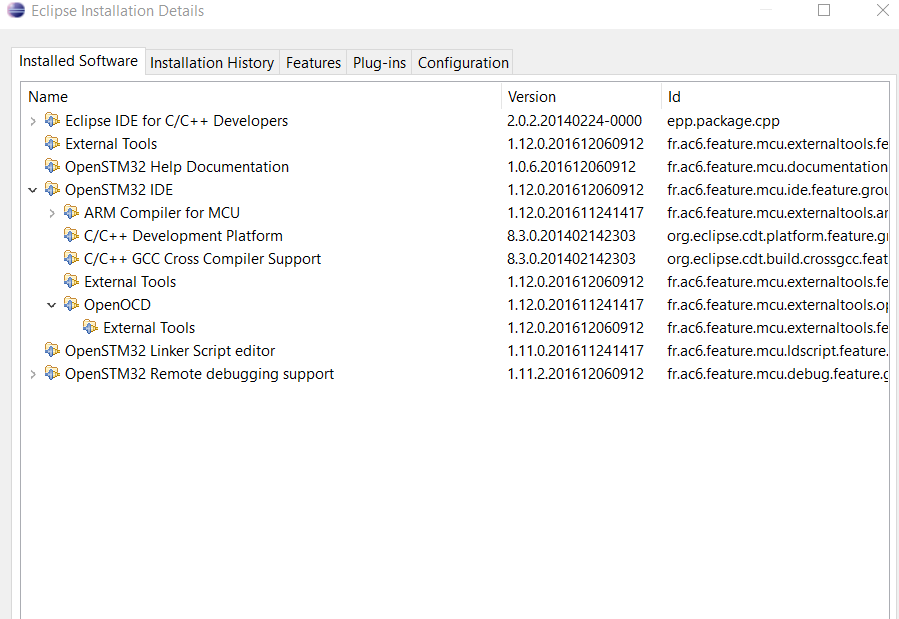

Posted on January 21, 2017 at 04:43
I have installed the software from the links you mentioned. Installation was successful. My OpenOCD version is same as yours 1.12.0.201611241417. I tried Debug after the update but I was getting the same errors again.
Thank you

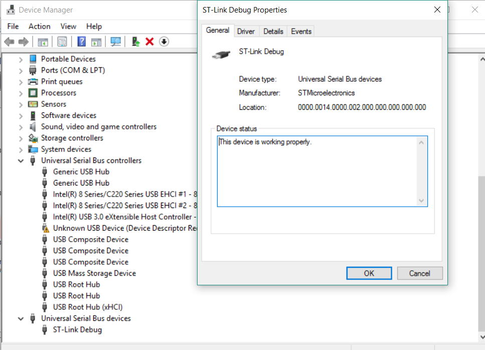

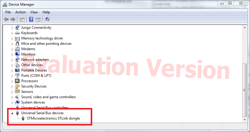

Posted on January 27, 2017 at 16:54
Hello Dheeraj,
Your USB error shows openocd failure.
Could you check under your device manager if the debug dongle is well enumerated as an universal serial bus ?
Like in that picture
Then by expanding STMicroelectronics STLink dongle, could you check if you have same as mine:
The next thing you can do is to upgrade your eclipse drivers to 1.13.
Kind regards
Sirma

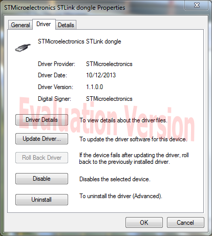

Posted on January 29, 2017 at 21:44
Here's what I have:
Different from yours
