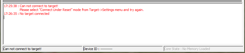

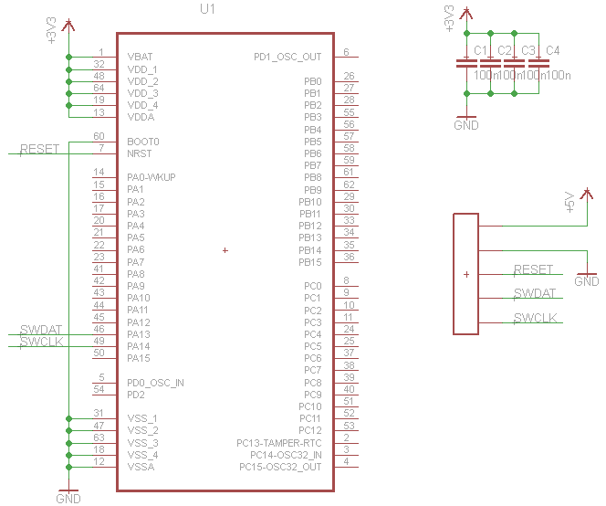

Hi! I am having problems to program a STM32F107 with the STM32F4-Discovery�s STLINK SWD. I�m wondering I have forgot something very essential.
This is the circuit I've mounted:

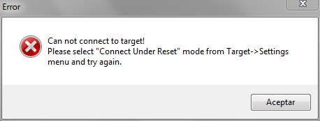

And these the errors I get:

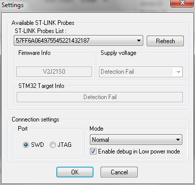

What I have done:
  • Check the connections
  • Check the supply
  • Start in the 3 different modes: Normal, Hot Plug, Connect Under Reset
  • Update Stlink firmware
Any idea what could be the problem? What is missing? I guess it must be something obvious but I don't see it :(
Thanks

Posted on May 25, 2014 at 18:29
Check that you have the pin orientation correct.
https://community.st.com/0D50X00009Xka68SAB
 Check that you have disconnected the F4 part from the ST-LINK, via jumpers and solder-bridges are required.I'd have a pull up on the reset, and bulk capacitors on the supplies.If it were my design I'd double check the pin#
Edit: Fixed DEAD LINK, original post from 25-May-2014
javi0034
Posted on May 25, 2014 at 19:25
Thank you. I'm afraid the problem is the orientation!!!
