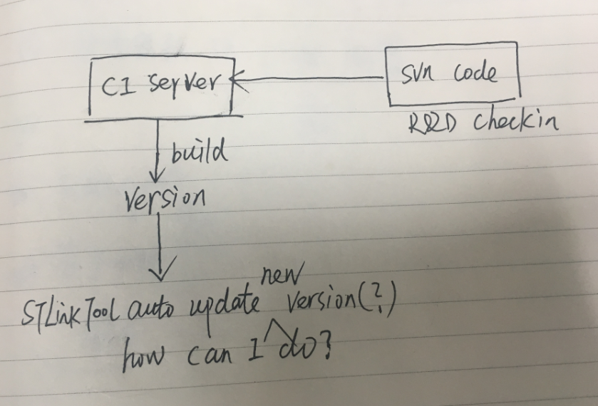

I am a test engineer in ABB of China. Now I need help .
My chip is STM32F051R8T6 in our target. After my company's R&D check in their codes, then build one version about the STM32F051R8T6 ,I need auto update this version on my target by the
,how can I do ?Whether the ST-LINK utility supports command line mode or not?
Thank you!

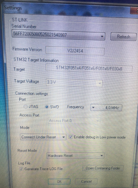

when I input
-c SN=56FF72065080525021540987 SWD UR LPM Hrst
-w32 -P C:\Users\tiandf\Desktop\HDI06_Alarm_V1.02_20160907_PP_STM32F051R8T6.hex 0x08000000the Stlink tool doesn't work and quit the ST_LINK_CLI

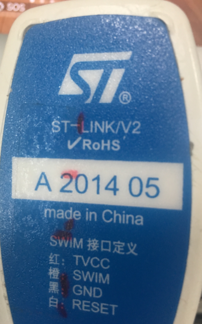

It seems that you are working under Windows OS.
What type of debugger do you use? STLink stand-Alone?
Which version ?Can you give more information (picture or schematic) concerning your Hardware setup ?
2017-08-18 3:10 AM
Ok great, your STLink probe is detected and also your STM32F0 target.
Now it should ready for Erase or write Flash operation.
Without using CLI mode but using .exe are you able to read memory of device and make a Flash erase ?
If yes you can download your .hex in Flash start 0x08000000 by using Target -> Program or shortcut below
Make sure Flash write protection is disabled (Option Byte Read Out Protection field)
Let me know.
