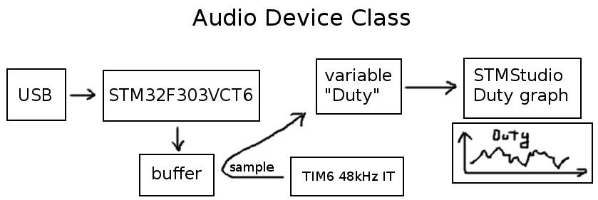

I'm trying to make STM32F3Discovery as an USB audio device. I want to stream audio to variable and use STMStudio to display graph for audio data. Later I want to feed PWM and control D amplifier.

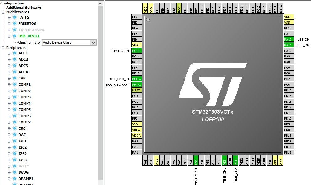

Pinout: Use Audio Device Class and PWM outputs.

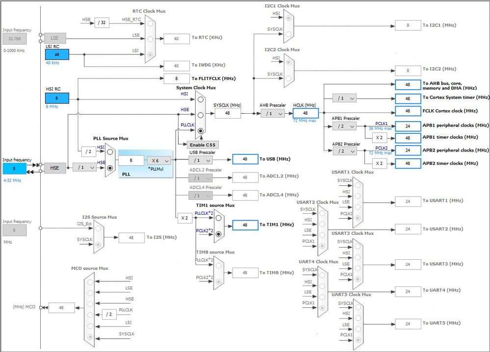

Clock configuration

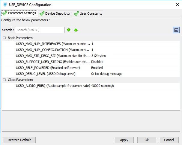

USB audio configuration
PC see board as speaker.

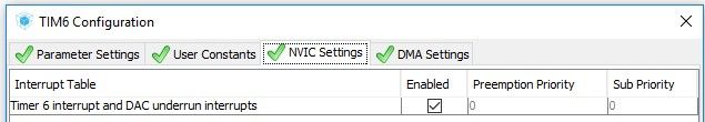

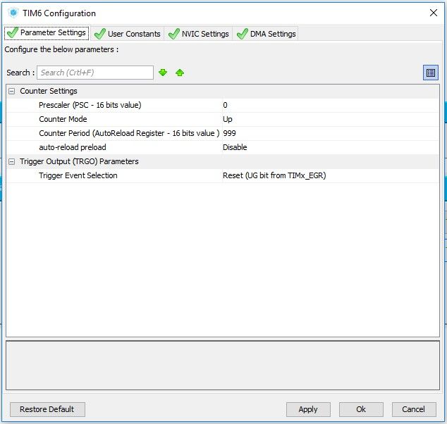

Timer configuration to generate 48kHz

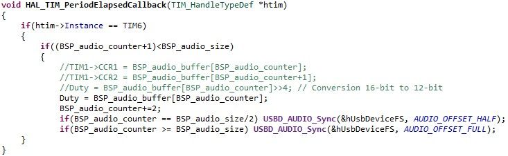

Timer 6 copy data to duty variable 48000 times per second. After receive half data execute audio synchronization and for full data execute audio synchronization.
Private variables to handle pointer to audio buffer, it size and word counter to send data.
Probably function below need something to work. Here i set buffer pointer, it size and set word counter to 0.
See Attachements 32942
