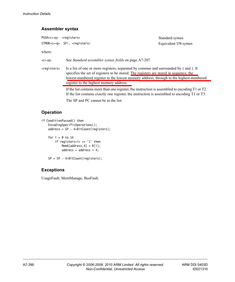

The processor does not work as you'd think, but it works according to its specification:
As it's PUSH where you don't have the registers in ascending order, you should've seen the "incorrect" (or unexpected) order of values on the stack.

And after reading your answer I have switched the orders of the registers when pushing them and now it works :D. Thank you! I was not aware they are pushed in ascending order I thought they are pushed and popped as I write them.
The snapshot you posted is from the ARMv7-M Architecture Reference Manual, correct?
Yes.
> I'm using Keil5.
It appears that this https://www.keil.com/support/man/docs/armasm/armasm_dom1359731150961.htm describes how do you enable a warning when the registers are not written in the "usual" ascending order.
