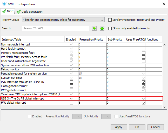

Itcouldbe clock related, or maybe you are missing the USB interrupts being enabled (check in CubeMX).
I take it you mean this?

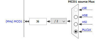

Maybe see if you can output the 48 MHz USB clock on the MCO pin to verify... can't remember off the top of my head if you can actually do that.
It doesn't look like I can do that. It looks like the closest I can get is 36 MHz:
