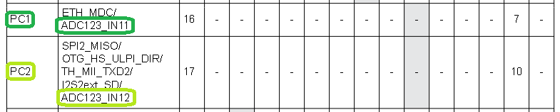

i saw that(ADC123) in the manual, but i needed to know corresponding GPIO pins with ADC3 and
Indeed
i couldn't understand that what is that(ADC123) ?
i mean that in the enabling RCC, which ADC should i Enable ?
  RCC_APB2PeriphClockCmd(RCC_APB2Periph_ADC3, ENABLE);
this is very vague for me!
what is ADC123 ?
ADC3, ADC2 or ADC1 ?

Posted on January 03, 2015 at 19:28
ADC123 means the pins are routed to all three ADC input muxs. ADC1, ADC2 and ADC3
Not all ADC input pins connect to all the ADC, but rather a subset. You should refer to the pin tables in the DATA SHEET to see the options for specific parts and pin outs. The
http://www.st.com/st-web-ui/static/active/en/resource/technical/document/reference_manual/DM00031020.pdf
will also describe the ADC pin mux.
PC1 and PC2 being specific pins identified in the USER MANUAL as available on your board, and being Channels 11 and 12 respectively. They might be confusing, but they are not vague.
