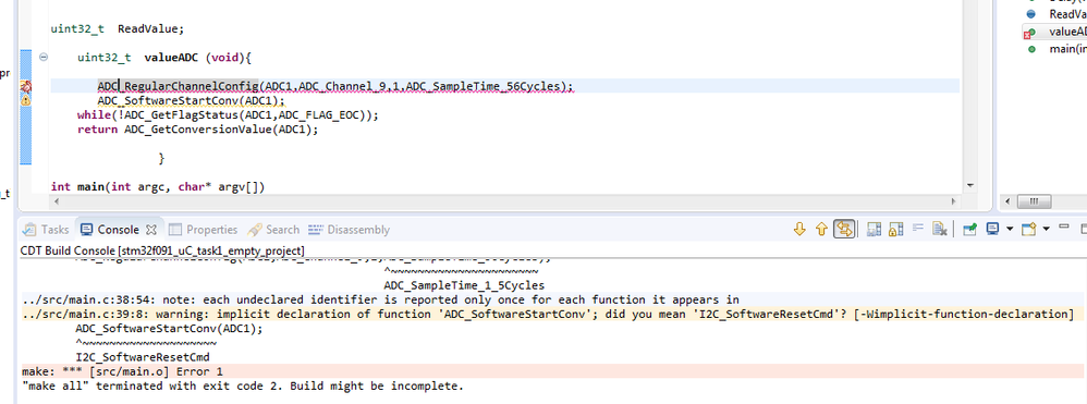

ADC STM32f0xx Hi everyone, I want to turn on LEDs whith a Potentiometer an ADC in STM32f091RC nucleo Board. I wrote this code, but it doesn't work. I am a beginner and I do not know where I have mistakes. I would be grateful if someone please help me.

I made a correction in the code let's try deleting the unit16_t part in while
Uint 16 in loop should be Uint 32 or Uint should not be written.

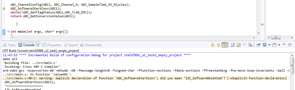

Thank you. I have now only this error. Because i use STM320XX.h i change the code.
 ADC_ChannelConfig(ADC1, ADC_Channel_9, ADC_SampleTime_55_5Cycles);
    ADC_StartOfConversion(ADC1);
that doesn't work yet :(

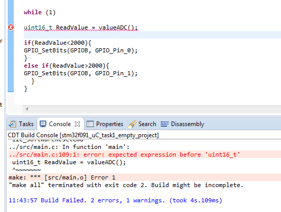

Nmo.1
bnymntrz
ADC_RegularChannelConfig(ADC1, ADC_Channel_9, ADC_SampleTime_55_5Cycles);
should be
Unfortunately, no. Does not work yet
