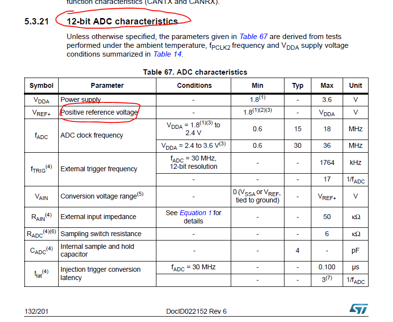

I am using STM32F407VG board. I wanted to know about the reference voltage and ADC resolution available on this board. I couldn't find the exact info related to these parameters in the datasheets.
