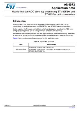

The picture you posted from AN4073 mentions only these STM32F4 MCUs as applicable:
STM32F405, STM32F407, STM32F415, STM32F417,STM32F42x, STM32F43x.
AN4073 is not applicable to STM32F446 since neither STM32F446 nor STM32F44x is in the list. Nor is the list open ended ... e.g. ending with ellipses, something like "STM32F43x, ...)".

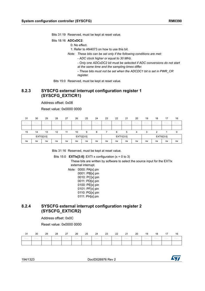

But here is a picture form STM32F446 reference, which points to AN4073:
The description of ADCxDC2 refers to AN4073 like this:
"1. Refer to AN4073 on how to use this bit."
Errata for STM32F446xC/xE refers AN4073 is a similar way.
It just looks like the list of applicable MCU in AN4073 is not complete (i.e. it is missing STM32F446).

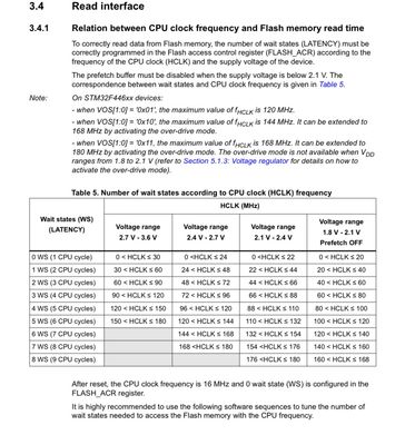

If I remember well ,  Indeed all STM32F4 MCUs designed after the STM32F427/429  - more than 10 years ago , have the same ADC bits to improve the accuracy. This Option 2 is a bit dangerous in case of ADC Frequency is less than 30MHz as such value is not by chance but is the Highest value for Flash Wait state  0 as below and indeed depends on Voltage range :
To activate this Option , we should ensure that our customers software is protected and so it consist on disabling ( gating) by hardware any access to the flash fetching during the sampling phase and ensure the timing window will fit correctly . If not CPU can access the Flash while the clock is stopped to flash and so make a hard fault or something like .
