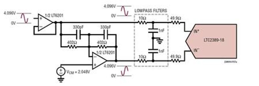

Am rigup the differential circuit and given AC input 1Vpp ,and DC offset is 1.6V(DC)
in Disco Board ADC1,channel1 as configure differential ADC here Negative input to A2 and positive input to A3 . i am receiving output negatives only and if i flat the graph for that readings noise is present . readings are like this bellow
ADC_Data:{-5235, -5969, -5201, -5292, -6159, -10756, -6630, -12241, -4321, -9101, -15071, -2818, -16790, -20914, -20897, -16385, -11901, -21713, -20216, -3024, -20810, -15934, -6547, -10002, -8465, -7612, -9142, -6656, -5910, -5231, -5039, -5078, -5145, -5064, -5052, -5133, -5088, -5064, -5037, -5058, -5422, -5040, -5040, -5124, -5378, -5964, -6880, -8817, -7214, -12120, -13670, -14444, -15717, -16831, -6232, -20115, -20883, -21120, -20974, -20255}
Whats wrong i made ? Any help ??

if you show the complete input circuit to the adc, it could be possible to help....

ok, ...from LT data; you build exactly so?
- adc data is uint32 , cannot be negative ! (you have wrong size, probably int )
- did you run "...calibrate() " ? (-> differential here)
- first check without AC signal: DC voltage at +/- IN pins
- check without AC signal: ADC values ...
- at first set no oversampling and no bit shifts, just to see the conversion result
