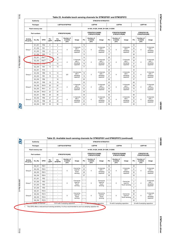

The TSC of the STM32F051K4 works fine for all channels except for channel 1 of group 2 (G2_IO1). It does work but gives values much lower than all other channels. Also the delta (when your finger is on the touchpad is way lower than for other channels.
1 - I tried changing the acquiring frequency, pulse high an low times, the IO-default-mode, prescaler values, max-count-values, nothing seems to help.
2 - What I tried was to disconnect the G2_IO1 pin completely, even then the values of it are much below other channels. So it wasn't a problem of the touchpad.
3 - Next I moved the sample capacitor to G2_IO1 and connected the touchpad to G2_IO4 (where the capacitor used to be). Instantly the values returned to normal. But all other groups work fine with the sample-capacitor on Gx_IO4.
4 - Then I build a second board with a fresh STM32F051K4, with exactly the same strange result, G2_IO1 seems not to want to be used as a touch sensor. Why?

This information is present in some of the relevant datasheets, e.g. for the 'L0; but absent from 'F0 DS (as footnote to  Capacitive sensing GPIOs available on XXXX devices table).
@Imen DAHMEN​ , can you please initiate an improvement for the relevant 'F0 DS?

Which pin is it? What is connected to it internally? From which VDD is this pin supplied? What else do you have connected to this chip and what does the code do? Try to search for this particular pin in errata, DS, RM, this site.
Thanks,
That's it.
I have it connected to PA4 (G2_IO1). And the description of reduced sensitivity is exactly what I see. But I do not see a reduced sensitivity on PA5 (G2_IO2).
As you mentioned to Imen, there is no mention of it in the DS, RM or Errata. But I had not read the UM...
So, I have to change the PCB.
Thanks !
Wilko
