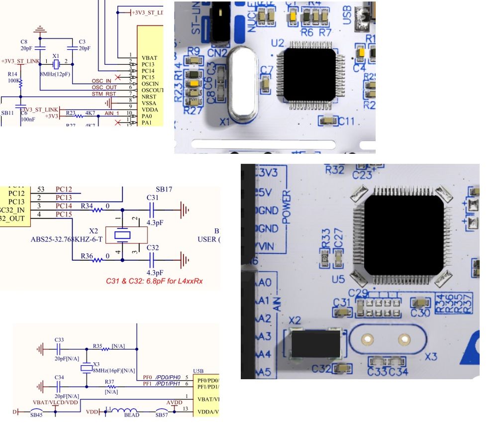

Hello i'm using CUBE 4.22 and i keep getting a conflict (see jpg bellow). when i click the checkbox USB->Device (FS), the TIM1 says ''!'' and shows several conflicts. and when i click on the Clock Configuration tab, the clock screen appears and i see a dialog box that says ''do you want to run the automatic clock issues solver?''. i click ''yes'' and then it says ''cannot find solution for some constraints''.
is there a way to resolve this problem? thanx

You didn't choose the right sub-family to have the crystal-less USB. Take a look there
http://www.st.com/en/microcontrollers/stm32f0-series.html?querycriteria=productId=SS1574
Only F0x2 and F0x8 have this mode.
Also on the nucleo you can have the clock coming from the ST-Link part, so you might have not noticed that you were using an external clock.

says that ''the clock source must use an HSE crystal oscillator'' but no the NUCLEO-F070RB does NOT have a crystal. here (see below) are the parts from the
http://www.st.com/content/ccc/resource/technical/document/user_manual/98/2e/fa/4b/e0/82/43/b7/DM00105823.pdf/files/DM00105823.pdf/jcr:content/translations/en.DM00105823.pdf
that illustrate the hardware:
in the image you can see crystal X1 connected only to the STLINK interface, you can see crystal X2 which is 32kHz, and you can see crystal X3 which is SUPPOSED to be connected to the 70RB chip according to the schematic, but it is clearly absent on the board itself. and yes i checked and that's what my board looks like. there is no crystal X3. the board is MADE by ST, and i did have a working USB connection on it, so i still dunno what to think. either the ST people need to proofread their docs, or there just isn't a definitive answer to this question. the circuit i'm making uses a 500kHz PWM and i have to be certain that the USB signals will have enough fidelity to work.

As Kraal suggested, your Nucleo board is likely using the MCO (Master Clock Output) from the ST-Link.  Although the F07 is not using the crystal directly, it's essentially the same as the 8 MHz crystal clock.
You should be able to put an oscilloscope probe on 'U5B pin 5' or the SB50 bridge and see an 8 MHz clock.
Posted on July 19, 2017 at 23:26
OK thanx i found what you're talking about. yes there is an MCO signal going to the 70RB chip. so it does have an external clock pulse. i been misled because of implications that i never tried to verify. the X3 is missing because it's an option in case i separate the STLINK from the uC. still,

I can appreciate the negative surprise.  Did you check to see if the similar parts with 'crystal-less USB' Kraal suggested may work, for example, STM32F072 [48 pin package, however] or STM32F042?
Posted on July 20, 2017 at 01:26
yeah that's a thought. it ***** having to figure this **** when i'm almost done with the whole development. the 42 chips are considerably more expensive. but if i have to pay for a crystal then maybe i should go with that. now i gotta go back and refigure a whole lotta stuff.....
Posted on July 20, 2017 at 07:24
well i got the LED to blink so it is running properly. but it ***** because i am gonna have to get a crystal. or change to a 042 chip. OH THE HUMANITY.....
