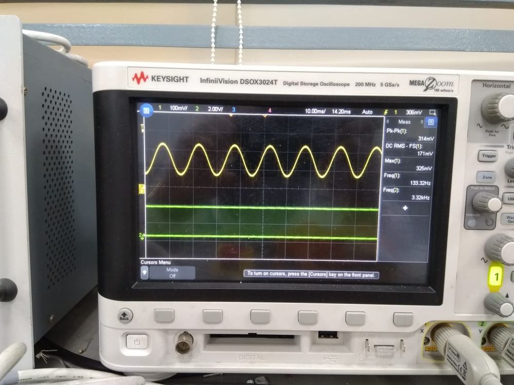

Hi all,
i am trying to generate a 3 phase sine wave with 120 degree phase shift by using stm32f030r8t6 nucleo board.
i can see the generated 3 phase sine wave on oscilloscope but the freq is not stable of the sine wave. it varies continuously from 40hz to 110 hz. please have a look on it and suggest me what can i do.
please find the attachment for code.

Thanks for your reply.
i am getting almost correct phase shift of 120 deg. my problem is that freq of sine wave is not constant and i am not updating freq in program.
In current program freq is varying continuously.

@TDK​
Yes, PWM can generate only square waves with desired duty cycle.
Here first i am calculating duty cycles values as per sine wave. and storing in array of size 100.
then initially i set timer1 ch1, ch2, ch3 at 120 phase shift duty cycle. and enabled the timer1 update interrupt.
my timer is set in center aligned mode. so i set rcr to odd value 5 so that every 6(5+1) pulses update interrupt generates. and in interrupt subroutine i updates the CCR!, CCR2, CCR3 values from array next index.
by this method (above programme) i can see generated 3 phase sine wave with 120 phase shift on oscilloscope .
but the issue which i am facing is that freq of generated sine wave is not stable it varies 50hz to 200hz. why it is happening even i am not changing the update interrupt rate (RCR) and ARR value. i have stuck at this point.
August 11, 2020
Okay, so duty cycle is varying between 0% and 100% over many timer updates to approximate a sine wave.
Can you measure the frequency your ISR is getting called? Is it varying between 50 Hz and 200Hz as well? It should be at a fixed rate.
Try in upcounting mode (as opposed to center aligned) to see if that's causing something odd.

@TDK
Yes​(10% to 90% it is my range forming a sine wave and generated sine wave is fine with 120 phase shift only problem is it is not maintaining stable freq.)
ISR freq is different from sine wave because for each cycle of sine wave I have 100 times timer1 update interrupt (for first 25 interrupt duty cycle goes to 50% to 90% then next 25 duty cycle goes from 90% to 50% then next 25 (50% to 10%) and then next 25 ( 10% to 50%)) to form (positive cycle then negative cycle) and and it repeats
for debugging purpose I have used a pin PA5 as it toggles whenever ISR is called
i will measure by tomorrow that at what freq it toggles, Yes it should be stable.
T​hanks for this suggestions I was also thinking about it to try.
I will try it by tomorrow.​
Thank you once again for your helping nature.​

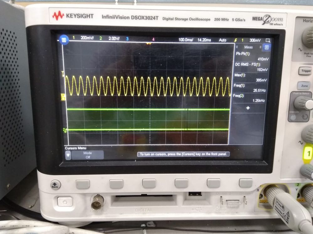

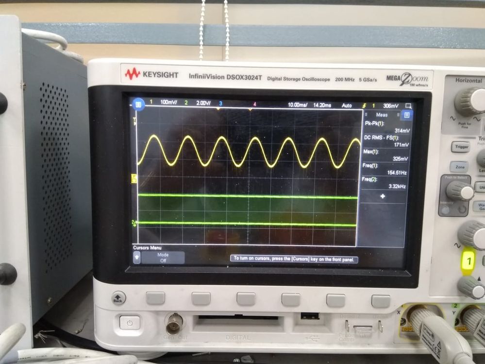

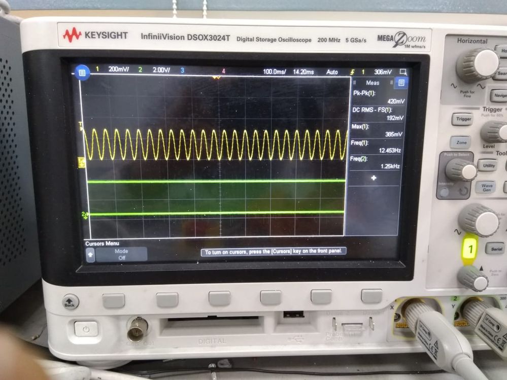

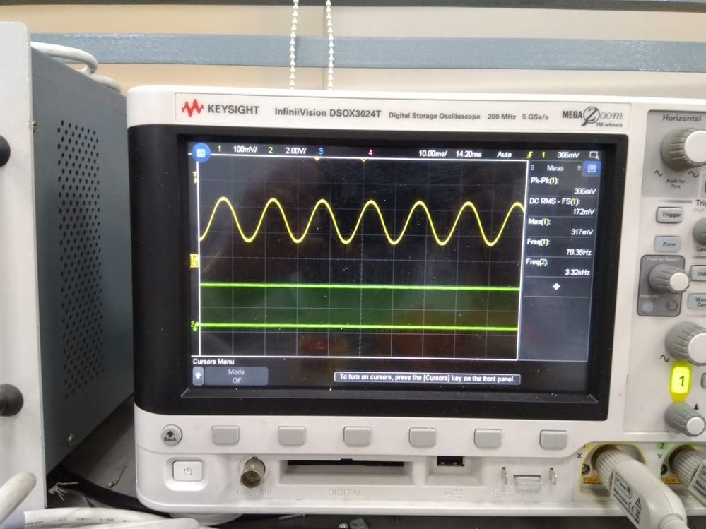

Sanju, There's two point in your code:
First, define variables that used in interrupt routines as volatile.
Second, for a 50 Hz sine wave with 100 samples, your sampling rate is 5000 Hz. and in your pictures your ISR frequency is very low. And in reality you should have 15 to 20 PWM pulse for each sample to have a stable PWM , if you have 16 pulse for each sample you need 5000 x 16 = 80,000 PWM frequency. For test you reduce Period to 599 so PWM frequency is 80,000 Hz. Adjust samples value by divide them by 2, and test again. also send us PWM signal picture too if possible.
sanju
sanjuAuthor
August 17, 2020
@Msd.1​
in my program whenever the ISR is called it toggles a pin PA5 (which is shown by green pulses in image) to debug the ISR calling freq.
So to be noted here that ISR toggles PA5 at each calling and update PWM duty cycle to form the sine wave.
to form a single pulse of sine wave there are 100 samples means ISR will be callled 100 times for one pulse of sine wave and PA5 will be toggled 100 times (100 times toggles makes 50 pulses).
so it means for every 50 pulses of PA5 (green color waveform) one pulse of sine wave will be generated.
if i notice from images there is two types of images (one for RCR=5 and Second one for RCR = 15)
CASE 1:
for RCR =5 freq is showing 3.32khz i.e. 3320hz.
so sine wave freq should be 3320/50 = 66.4hz
CASE 2:
for RCR =15 freq is showing 1.25khz i.e. 1250hz.
so sine wave freq should be 1250/50 = 25hz.
when this will be ok i will set program for different freq. my project is not to generate sine wave of 50hz it is to drive DC servo motor.
Note: PA5 is not in above program but it is in the conversation held already.
