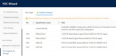

Does anyone know how to connect X-NUCLEO-IHM08M1 with NUCLEO-U575ZI-Q?
CN11 and CN12 of NUCLEO-U575ZI-Q will be connected to CN7 and CN10 of X-NUCLEO-IHM08M1 respectively?  Pin 1 of CN11 and CN12 are connected to Pin 1 of CN7 and CN10?
Thank you
1 REPLY 1
GMA
Hello @Suthan,
Pin 1 of CN11 and CN12 of NUCLEO-U575ZI-Q must be connected to Pin 1 of CN7 and CN10 of X-NUCLEO-IHM08M1.
Refer to the Workbench pins usage and hardware changes tab for hardware modifications if needed.
