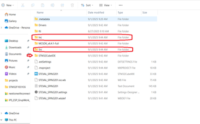

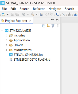

Hi everyone,
My evaluaiton bord is STVAL-SPIN3201 and I am using Motor Control Workbench 6.4.1.
First of all I work with Motor Control Workbench , after work CubeMx program and generate code and finally open CubeIde but I did not see Core folder. I dont know how can write my motor control program in main().c .
When open "C:\Users\eem_o\.st_workbench\projects\STEVAL_SPIN3201 " folder "Inc" and "Src" folder in this area.
When try to transfer at STM32CubeIde folder "Inc" and "Src" folders, given to many error.
How can solve this issue?
1 REPLY 1
STuser2
Senior III
Don't transfer the files src and inc into Cubeide, write your program in either main.c in src folder or create a new .c file in src folder.
