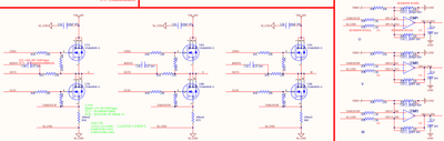

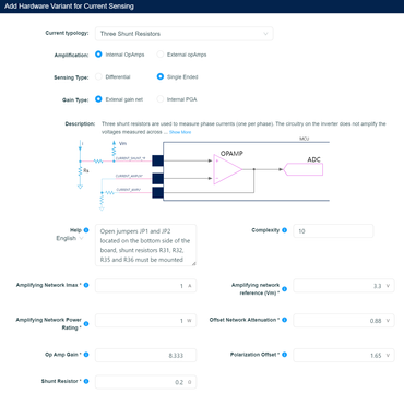

I have a DIY board similar to EVSPIN32G4. Below is the three-shunt sensing circuit(In internal OpAmps, differential, external gain mode)

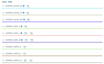

Because the STSPING4 doesn't support internal OpAmps, differential, external gain mode, I just use the below config to generate the project(seems differential or single-end does not influence the code, yes?), see the project in the attachment:
And because the EVSPIN32G4 project's encoder and hall sensor use the same GPIO, I only enable the encoder in the MCSDK project.
After generating the code, I added the hall signal pin in STM32CubeMx and then compiled the MDK project successfully.

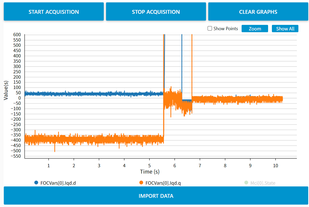

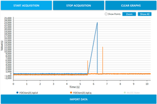

And then this code outputs the following LOG:
00> HALL[2], elAngle[0]
00>    4ms, sta[ 0], occF[0x00], curF[0x00], cmdSta[1]
00> MC_StartMotor1[true]
00>    4ms, sta[16], occF[0x00], curF[0x00], cmdSta[1]
00>   14ms, sta[ 0], occF[0x00], curF[0x00], cmdSta[1]
00>   16ms, sta[17], occF[0x00], curF[0x00], cmdSta[1]
00>   16ms, sta[16], occF[0x00], curF[0x00], cmdSta[1]
00>   26ms, sta[ 2], occF[0x00], curF[0x00], cmdSta[1]
00> HALL[6], elAngle[16384]
00> HALL[4], elAngle[16384]
00> HALL[5], elAngle[16384]
00>  727ms, sta[20], occF[0x00], curF[0x00], cmdSta[1]
00> 1127ms, sta[ 6], occF[0x00], curF[0x00], cmdSta[2]
00> 1127ms, sta[ 6], occF[0x00], curF[0x00], cmdSta[0]
00> 1127ms, sta[ 6], occF[0x40], curF[0x40], cmdSta[0]
00> 1128ms, sta[10], occF[0x40], curF[0x00], cmdSta[0]
00> 1129ms, sta[11], occF[0x40], curF[0x00], cmdSta[0]
From the LOG, we can see that the hall valve has been changed (the motor is always stopped at a special position where the hall value is 5), and finally it stops.
What's the reason for the error MC_OVER_CURR? How can I resolve it?
BTW, if I change ".DAC_OCP_Threshold = 7427," to ".DAC_OCP_Threshold = 9000,", the motor will be shocked after start. Where does the value 7427 come from?
