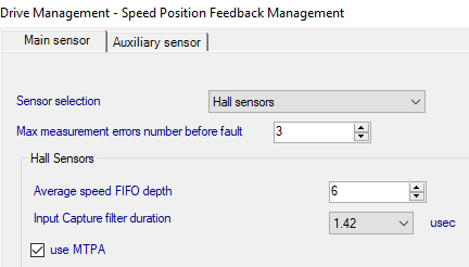

What is the Hall sensor MTPA?
‎2020-08-30 12:16 PM
What is MTPA in the MC workbench speed position feedback management --> Hall sensors? This is NOT the Maximum Torque Per Amp, I believe. Any reference for this?

‎2020-10-11 11:11 AM
It seems to be some kind of interpolation algorithm to estimate the position of the rotor based on the 6 ticks (rising edge and falling edges) of the 3 hall sensors.
They talk about it in a ST Video at 16:30 - https://www.youtube.com/watch?v=dt6bGpykerE
