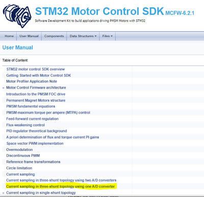

>But maybe you are combining multiple steps here--I think it's actually the time it takes the CPU to execute the FOC algorithm that determines how often it can initiate a new PWM cycle? Yes !
>And you speak of "ADC samples". Is it that the ADC has to be synchronized with the PWM cycle, because it samples during a window that is phase locked with the PWM cycle? Yes !
I think the answers to your questions are fully described in the User manual in the highlighted section:
In any case, it sounds like the STM32F0 cannot reach a 1.5 kHz electrical speed, but the STM32G4 is able to do so. Correct?
Yes.
And at 30 kHz PWM and 1.5 kHz electrical cycle, there are 20 PWM *output* steps per cycle. Is that enough to get a reasonably clean waveform? Yes, it is.
> Would we get much better performance if we used an even faster MCU with an external gate driver, so we could reach a higher PWM base frequency? I do not think so, Increasing PWM frequency has also some drawbacks. Commutation losses is one of them. I would advise you to select one MCU with at least 3 ADCs. STM32G4 (Or STSPIN32G4) is a pretty good choice, and if you want to test our new HSO algorithm, it is the only possibility.
