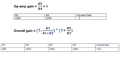

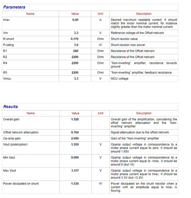

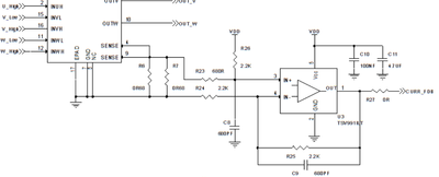

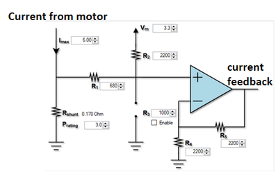

1) What is the Formula to convert the Current feedback Output from OPAMP ?
2) What is the relation of the voltage read in current Feedback pin and the motor Current value?
Zied b.
Hello @NIVI ,
In the attached file you will find all the necessary information for the opamp on ihm11, in the picture below, how the calculations are made:
Regards
If you agree with my answer, please accept it by clicking on "Accept as solution".
