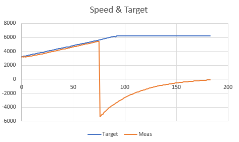

In speed_torque_cntrl.c in routine int16_t STC_CalcTorqueReference( SpeednTorqCtrl_Handle_t * pHandle) the function SPD_GetAvrgMecSpeedUnit(pHandle->SPD ) is called to get the average velocity. This routine accesses the velocity from a structure updated from the first function above. This routine is apparently overflowing as indicated by logging the return data shown below.
The ST code in this function uses a variable int32 wAux that overflows. The beginning values fits int32 and the final value fits int16 but an intermediate value overflows int32. My revised solution was to make wAux int64_t.

With this change the overflow limit speed was changed from an electrical speed of 327Hz to a much higher level, limited by other restrictions not encountered.
In the original trouble spot the overflow limit was 2^31. Using a speed resolution of _001Hz == 100 the electrical frequency at which overflow occurs is 2^31/(100 * 2^15) = 327.68 Hz.
