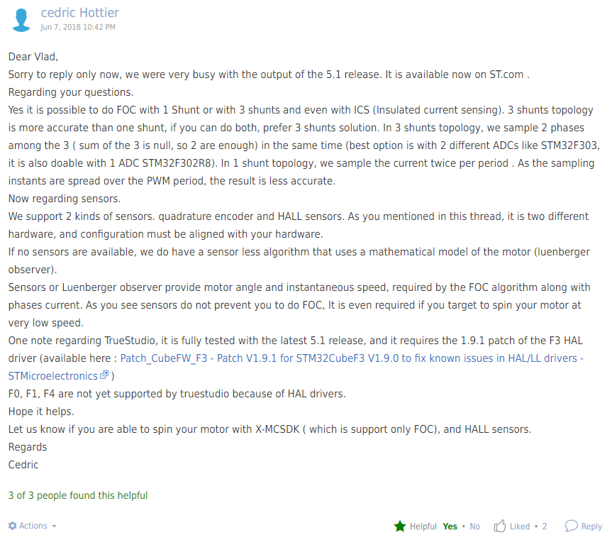

Hi there,
I just got a STEVAL-SPIN3201 eva board. I generated a example project(trueStudio) by MC workbench. The code is larger than 32k no matter I use HAL or LL driver. If I enable optimize for code size the code size would be 25.7k if I LL driver when generating the code. For HAL driver, no matter I enable code size optimization or not, the code size is larger than 32k.
1. Is there any other way to reduce code size?
2. by the way, I tried to use the motor profiler, and I found  STEVAL-SPIN3201 is not supported. Will it be supported later? If not is there any guide for tuning the parameter of the motor?
Best Regards,
#flash-overflow #.text-not-fit-in-flash #sdk-v5.1.1 #sdk-5 #sdk-v5 #mc-workben #stm-mcu #truestudio-9.0.0 #truestudio9
Diandi Zhu
Posted on July 11, 2018 at 18:57
https://community.st.com/0D70X000006SsE0SAK
seems trueStudio is not supported yet due to drive issues.
