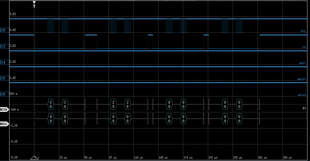

I am using IHM02A1 expansion board (on top of L073RZ), which has two L6470 connected in a daisy chain configuration. I cannot receive any data from the devices. What do you think the reason can be ?
Below is the bus status of a reset and get param for register ACC (0x5) since its default value is not 0:

Meanwhile I found a 072RB and wanted to try the SPN2 firmware. I programmed the binary and I run it without connecting any motor and I was still seeing 0s (I didnt change the probe locations) and on the UART output it was also all 0s. Then I thought maybe I need to connect VS, I did and I see both on the oscilloscope and on the UART output some activity. It seems VS needs to be connected and I missed that in the documents.
Mete
I should have read the datasheet carefully, so I think it is particularly about this:
"During power-up, the device is under reset (all logic IOs disabled and power bridges in high
impedance state) until the following conditions are satisfied:
- VS is greater than VSthOn
- VREG is greater than VREGth = 2.8 V typical
- Internal oscillator is operative."
which are naturally not satisfied if VS is not applied.
Hello @mete​ ,
I confirm that the device must be supplied through VS main power supply and the VREG voltage is internally generated starting from VS.
The VDD pin voltage sets only the logic output pin voltage range, is not sufficient to operate the SPI.
Let me know if we can consider solved the problem ;)
If you feel a post has answered your question, please click "Accept as Solution"
Hello @Cristiana SCARAMEL​,
Good to know "The VDD pin voltage sets only the logic output pin voltage range, is not sufficient to operate the SPI.", I was not sure about that.
Yes it is solved, I am working with it without a problem.
