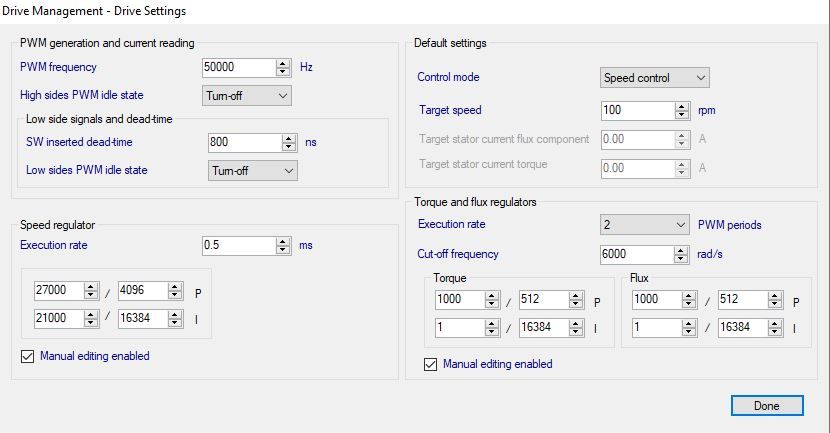

I am using the NUCLEO-F303RE and NUCLEO-IHM08M1 to drive a maxon 48V DC motor with incremental encoder (1024 counts). I have used the motor profiler and motor control workbench, the PID values automatically generated were completely wrong and the motor would loose smoothness at speeds below 700RPM or 500 RPM. After spending months I have identified the issues and adjusted the PIDs so I can now drive the motor as slow as 45 RMP and keep a good smoothness. However the requirements of the project need the motor to run as slow as 1RPM. The drive settings I am using are below. Is there anyone that has experience with BRUSHLESS MOTORS AND/OR the NUCLEO-IHM08M1?

I am still working on this project, I have achieved speeds as low as 6 RPM however I am not able to rotate any slower. I have tried using the MCBW monitor and set different speeds however any speeds requested below 6 rpm results in a blocked rotor. Recently I have been advised (from a ST community member) to try the position control instead of speed control, I have created a project however I haven't had enough time to tune the PIDs yet but I'd appreciate your feedback on this, can I achieve 1RPM as slowest speed with position control? as well as maximum speed of 6000 RPM? Is there any better option?
The requirements of the project are the followings:
1) FOC control
2) minimum speed: 1rpm
3) maximum speed: 6000 rpm.
I'd appreciate any help
