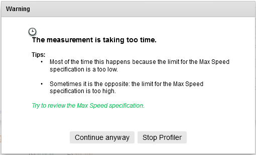

Motor Profiler and P-NUCLEO-IHM03 does not work (time out every time).
GBM2804H-100T Motor Specifications:
Configuration: 12N14P
Max Rotation Speed: 2180
Test Current: 0.0099A
Max Current: 5A
Which settings for Motor Profiler works with the P-NUCLEO-IHM03 ?

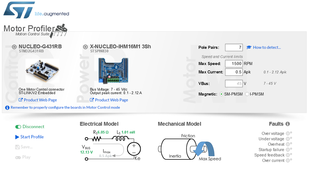

Could you attach a screenshot of your Motor Profiler settings into this thread?

Often when I Start Profile the Rs and Ls values of Electrical Model becomes wrong:

One of our team members reproduced your configuration and setup and met the same error.
For some motors, most especially small ones, you have to try to tune a little bit more.
In your case, if you replace Max current of 0.5 Apk by 0.1 Apk (in your first screenshot), the Motor Profiler runs and converges.
Could you try this and keep us informed on the outcome?
Best regards
Laurent Ca...

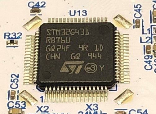

However 0.1 Apk did not work with my Nucleo G431 Revision Y:
But replacing the Nucleo-G431 with Nucleo-F303RE fixes everything:
Now my motor profiler finally works.
