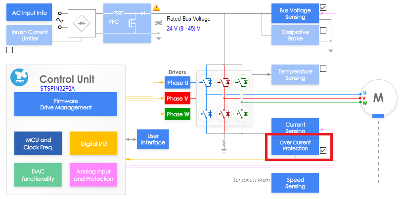

hi sir i am using motor control workbench generated foc sdk and running motor of 6 pole bldc successfully but in my application of motor heavy load is given on motor so it indicate over current fault so please guide me to by pass overcurrent fault from generated code no matter rpm goes down

Hi @Ryada.1​ ,
to disable the over current protection you can unchecked the protection in your Project (see figure below):
Anyway before disabling this protection, did you try to increase the over current threshold according to your application requirements?
You can find more details on how to drive a motor with FOC algorithms using the STEVAL-SPIN3202 board in the user manual UM2278 and UM2168
