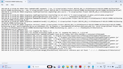

MotorControl reference pack not found
wliu.2
2023-03-25 18:35:21,503 DEBUG [Main.lambda$run$0] Arguments: [-ioc, E:\t1\6Steps-NUCLEOF401RETx-IHM07-BullRunning\6Steps-NUCLEOF401RETx-IHM07-BullRunning.ioc, -xdm, E:\t1\6Steps-NUCLEOF401RETx-IHM07-BullRunning\6Steps-NUCLEOF401RETx-IHM07-BullRunning.wb_def]
2023-03-25 18:35:21,506 DEBUG [ArgsValue.readPropertiesFile] [AppConfig] pack.source = "D:\Program Files\STMicroelectronics\MC_SDK_5.4.8\Middlewares\ST\MotorControl"
2023-03-25 18:35:21,506 DEBUG [ArgsValue.readPropertiesFile] [UserConfig] do not exist in "C:\Users\Admin\.st_motor_control\wb2mx.properties"
2023-03-25 18:35:21,506 DEBUG [ArgsValue.getConfigProperties] pack.source = "../../../../Middlewares/ST/MotorControl"
2023-03-25 18:35:21,513 DEBUG [ArgsValue.lambda$retrieve$2] CLI_ARG[xdm]: E:\t1\6Steps-NUCLEOF401RETx-IHM07-BullRunning\6Steps-NUCLEOF401RETx-IHM07-BullRunning.wb_def
2023-03-25 18:35:21,513 DEBUG [ArgsValue.lambda$retrieve$2] CLI_ARG[ioc]: E:\t1\6Steps-NUCLEOF401RETx-IHM07-BullRunning\6Steps-NUCLEOF401RETx-IHM07-BullRunning.ioc
2023-03-25 18:35:21,514 DEBUG [ArgsValue.retrieve] {xdm=E:\t1\6Steps-NUCLEOF401RETx-IHM07-BullRunning\6Steps-NUCLEOF401RETx-IHM07-BullRunning.wb_def, updftl=templates/wb_ioc_mc-middleware.ftl, mx_timeout=-1, exp=templates/wb-defines_where_and_what.txt, ioc=E:\t1\6Steps-NUCLEOF401RETx-IHM07-BullRunning\6Steps-NUCLEOF401RETx-IHM07-BullRunning.ioc, pack=../../../../Middlewares/ST/MotorControl, ftl=templates/wb_ioc_template.ftl}
2023-03-25 18:35:21,573 DEBUG [Main.run] Targeted MCU family = F4
2023-03-25 18:35:21,594 DEBUG [Main.run] Minimum associated CubeMx to the `F4` targeted MCU family is `4.25.0-a0`
2023-03-25 18:35:21,605 DEBUG [WindowsCubeMxFinder.lambda$findThem$2] Found 64-bit subkey HKEY_LOCAL_MACHINE\~~~\Uninstall\STM32CubeMX
2023-03-25 18:35:21,611 DEBUG [CubeMxCtx.EXE_version] Loaded path: 'D:\Program Files\STMicroelectronics\STM32Cube\STM32CubeMX\STM32CubeMX.exe'
2023-03-25 18:35:21,611 DEBUG [CubeMxCtx.EXE_version] Loaded updater jar: 'D:\Program Files\STMicroelectronics\STM32Cube\STM32CubeMX\plugins\updater.jar'
2023-03-25 18:35:21,624 DEBUG [CubeMxCtx.EXE_version] Loaded path: 'D:\Program Files\STMicroelectronics\STM32Cube\STM32CubeMX\STM32CubeMX.exe'
2023-03-25 18:35:21,624 DEBUG [CubeMxCtx.EXE_version] Loaded updater jar: 'D:\Program Files\STMicroelectronics\STM32Cube\STM32CubeMX\plugins\updater.jar'
2023-03-25 18:35:21,634 DEBUG [CubeMxCtx.EXE_version] Loaded path: 'D:\Program Files\STMicroelectronics\STM32Cube\STM32CubeMX\STM32CubeMX.exe'
2023-03-25 18:35:21,634 DEBUG [CubeMxCtx.EXE_version] Loaded updater jar: 'D:\Program Files\STMicroelectronics\STM32Cube\STM32CubeMX\plugins\updater.jar'
2023-03-25 18:35:26,694 DEBUG [CubeMxCtx.EXE_version] Loaded path: 'D:\Program Files\STMicroelectronics\STM32Cube\STM32CubeMX\STM32CubeMX.exe'
2023-03-25 18:35:26,694 DEBUG [CubeMxCtx.EXE_version] Loaded updater jar: 'D:\Program Files\STMicroelectronics\STM32Cube\STM32CubeMX\plugins\updater.jar'
2023-03-25 18:35:26,729 DEBUG [EnvironmentChecker.checkPack] STM32CubeMX.Version: 6.8.0-RC4
2023-03-25 18:35:29,171 ERROR [LineInfo_to_exitCode.manage_MCPackNotFound] MotorControl reference pack not found: "../../../../Middlewares/ST/MotorControl"
comleted with errors~~
So why?

Hello @wliu.2​ ,
According to the release note of the MCSDK version 5.4.8 it seems that we can use at most the STM32CubeMX v6.4.0 version, can you try with this version and tell me if it works?
Thanks

I encountered the same problem, but using cubeMX6.4.0 and MCSDK5.4.8 together did not work.
will it work with STM32CubeMX 6.9.1 version, I have the MCSDK version 5.4.8.
I'm also encountering the same issue.
The MCSDK version is 5.4.8 and the STM32CubeMX version is 6.9.1
