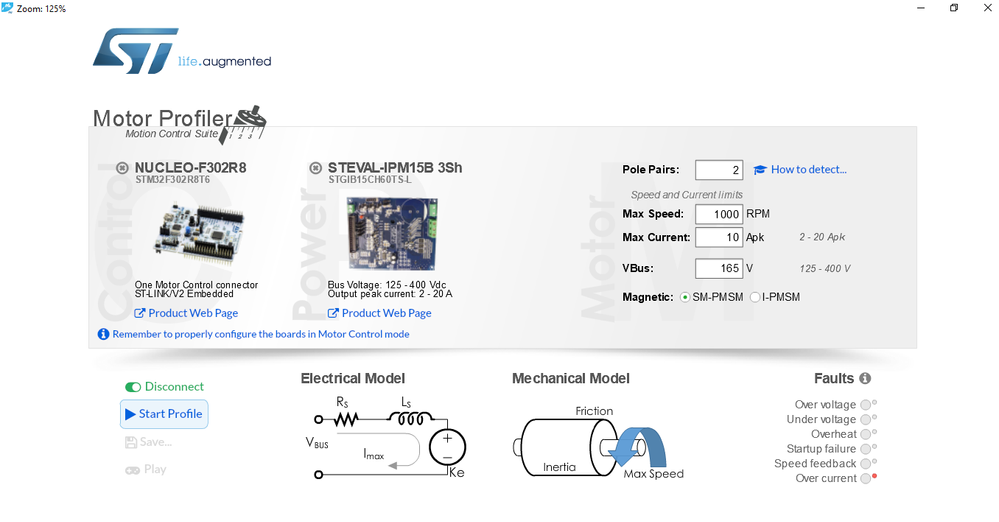

I have IMP20B with Nucleo Board F302R8.
I tried with Motor Profiler. In over current small dot shows red and profile failed.
With same configurations i tried once & motor runs a bit.

Darshan Patel
Hello Just Zoom the corner Faults Section, Its due to External SMPS???
Sorry will take care of that from now onwards
When i press start profile to set the profile at that time process few seconds & then goes into over current fault with small dot showing red.

Hi Darshan,
I'm here following the link in this previous post.
I see from the screenshot the board selected in the profiler is IPM15B.
However you mentioned that you have a IPM20B. Do you confirm ?
If so, consider that the two boards are different, so maybe it could be the cause of this issue.
Moreover, even without any error, using a different board bring to an incorrect profiling of the motor values.
Yes you are right i used IPM20B instead of IPM15B.
I agree with your feedback with using IPM15B. but motor once runs for few seconds.
I ordered IPM15 already.
