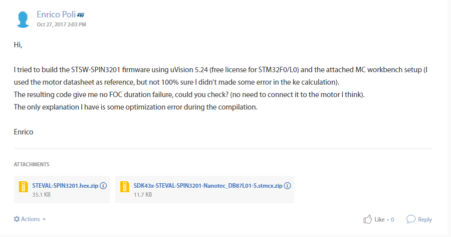

Enrico Poli
Posted on October 27, 2017 at 15:03
I tried to build the STSW-SPIN3201 firmware using uVision 5.24 (free license for STM32F0/L0) and the attached MC workbench setup (I used the motor datasheet as reference, but not 100% sure I didn't made some error in the ke calculation).
The resulting code give me no FOC duration failure, could you check? (no need to connect it to the motor I think).
The onlyexplanation I have is some optimization error during the compilation.
Enrico

Posted on October 30, 2017 at 10:09
The attachments should be visible in the bottom of my reply.
You can upload attachments using the advanced editor (upper right corner in the reply box).
Posted on October 30, 2017 at 15:17
By the way... the attachments are not visible in the forum stream, you must open the
https://community.st.com/0D50X00009XkXBLSA3
