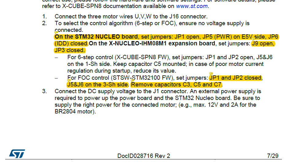

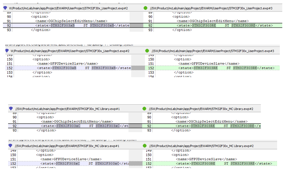

First I configured the
X-NUCLEO-IHM08M1 for FOC control as described in UM1996 DocID028716 page 7,
then, yes, I generated the header files from ST MC Workbench,
and then I selected the 303C project and modified the MCU to 303RE.
(I think this is the essence - it was a lot of trying and testing, so it may be some steps I'm missing)
See appended images for some details.
