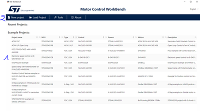

Hi, I am having a trouble using MCWorkbench 6.1.1
When downloading a project generated from MCWorkbench demo to my B-G431B-ESC1, this happens
(the rotor moves for some angle per each second while making a wierd noise. It temporarily stops when I push the start/stop button in the ESC(ESC generates low beep sound))
ST-Link FW : V2J41M27
Demo : Electronic Speed Control on B-G431B-ESC1 kit
I did not modify any .ioc file(cubeMX) or  .cproject
Any advice would be helpful.

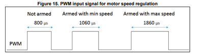

If you want to use the "electronic speed controller" of this board:
The electronic speed control (ESC) feature allows to control the motor speed with a PWM signal in input, for example on the B-G431B-ESC1 boards it is possible to use this feature to control the motors of a drone sending a PWM signal with a different duty cycle to switch the motor to armed, armed with a minimum speed, armed with a maximum speed and unarmed state.
You can find more details on this example on this link : click here
on the chapter "Connection and first execution of the electronic speed controller (ESC) program"
otherwise, you can generate a project by pressing "new project" in the workbench, import your profiled motor, generate and flash the project and control your motor with the Motor Pilot

Did you use the default project (number one) or generate a new project (number 2)?
If you agree with my answer, please accept it by clicking on "Accept as solution".
I used the default project
