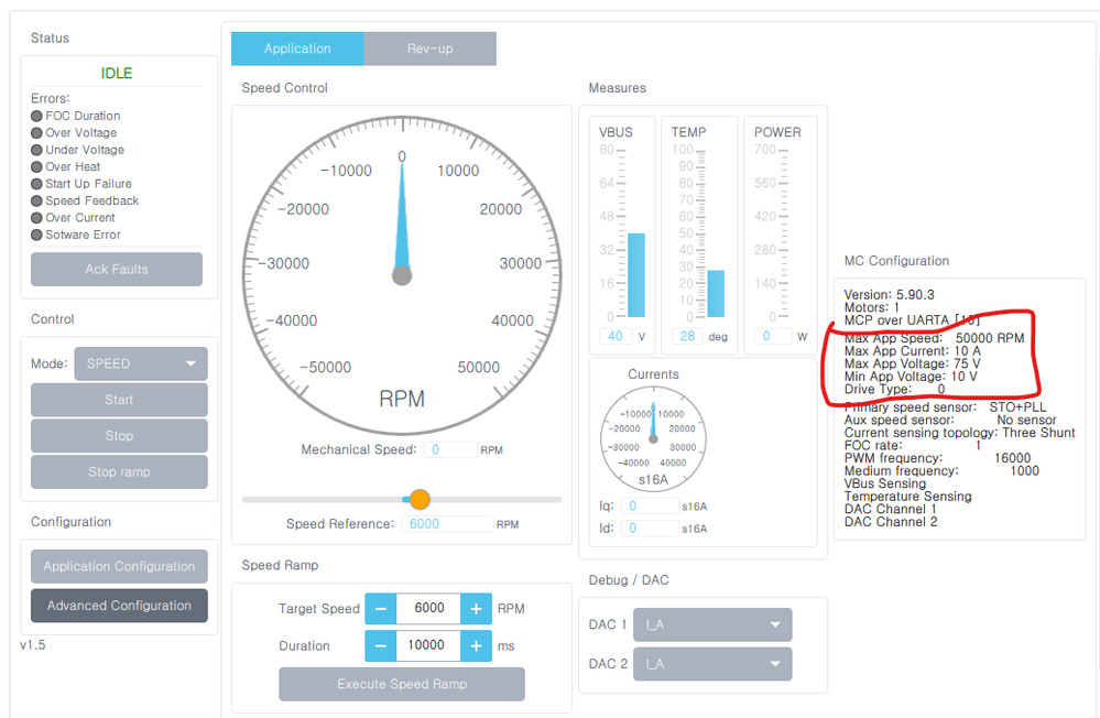

I am setting up a SPMSM driving system with EVSPIN32G4 and ST Motor Control Workbench.

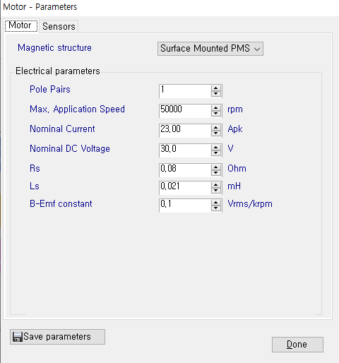

In ST motor Control Workbench, I set the nominal current as 23 Apk.
However, the max app current is determined to 10A in MOTOR PILOT.
I attached screen shots about this.
What I want to know is how the max app current is determined and how I can control it.
Incidentally, I want to drive my motor at 15Arms and 30V.
Best regards,​

Hi @JLee.56​ ,
The Max App Current value in the MC Configuration panel is not correct in the 5.Y version.
This value is not used anywhere and is just informative. Obviously in this case it is a false information that would have been better to filter. The new MCSDK-6 will fix this issue.
