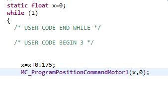

Is anyone able to drive a BLDC motor at low speeds? anything below 6 RPM?
msingh
Senior
I am using the X-NUCLEO-IHM08M1 as a power board and NUCLEO-F303RE as a control board. Using an incremental encoder of 1024CPT I was able to drive the motor as slow as 6RPM, even after several attempts I was unable to achieve any lower speeds. When I request any lower speeds the motor stops and goes into the "lock rotor" meaning the motor stops rotating but still draws current.
Thanks In advance

Hi @Imen DAHMEN​ ,
I used position control instead of speed control which allowed to rotate slower than 6RPM, then adjusted PIDs to eliminate overshoots and vibrations, then I just had a bad connection and the motor simply stopped rotating ( I thought it was a firmware issue but it wasn't as it stopped working with the previous version of firmware) .
PID tuning is really a big issue. Personally I do not reccomend the Motor profiler as it is not usefull at all, the parameters should be used from the motor datasheet and PID tuning should be done manually.

Position control mode - AN5464 and set Duration to zero. It works.

Good morning mscot.1,
Thank you once again for your suggestion I have created a project using the AN5464 and the motor is able slower than 6RPM (I think) however I cannot use the "follow mode" as mentioned in the application note. When I set the duration to 0 it should start a continuous rotation if i keep updating the position however the rotor doesn't move at all. Is there any suggestion you have?
I would appreciate your help.
Kind Regards
Manpreet Singh
mscot.1
Sorry, I have not got anything more to offer; I followed the App Note and achieved the motor moving between 2 positions. Then I set the duration to zero and advanced the angle in a loop and it worked. That is as far as I went.
would you be kind enough to share the "loop" you have please?
I am able to move between 2 position however I cannot achieve any continuous movement, below is the code I am using.
msingh
Senior
Actually I have identified the issue. THANK YOU VERY MUCH FOR YOUR HELP. MUCH APPRECIATED :)
