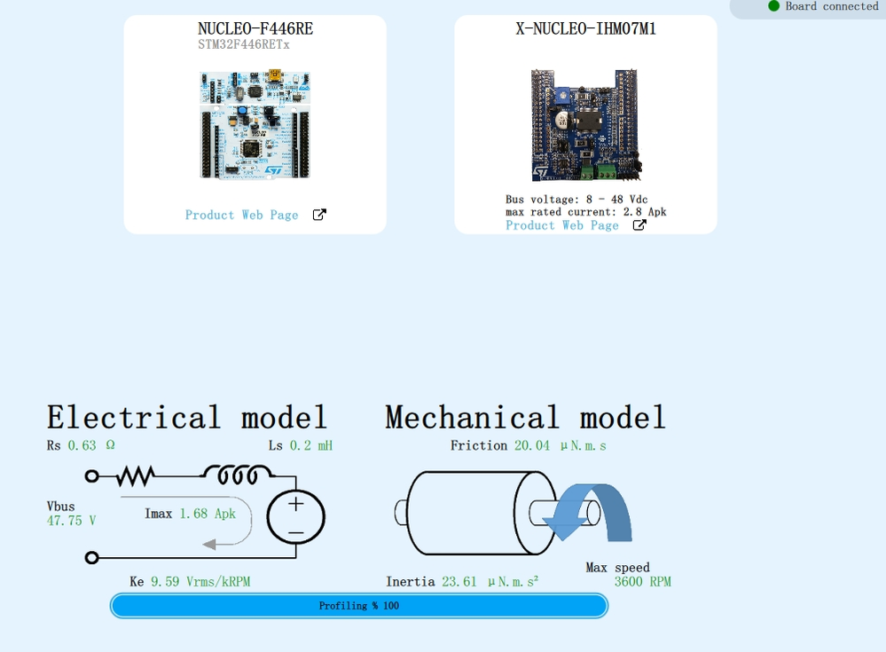

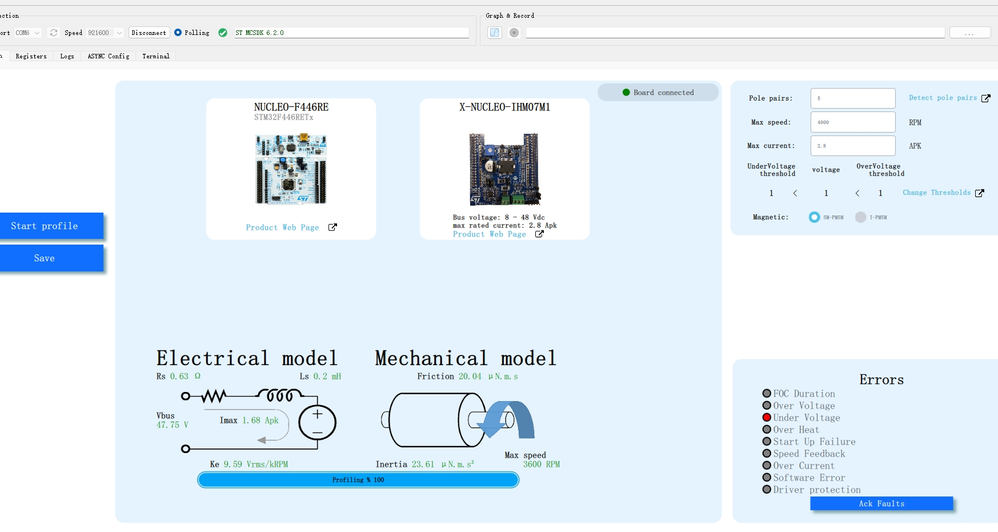

Hello.
I use 5.Y.4 MCSDK and NUCLEO-F302R8+X-NUCLEO-IHM08M1 3Sh,with 48V 471W pmsm motor. The motor keeps turning and cannot identify the Ke.
Can you try with the new version of MCSDK 6.2, and tell me if it works better. To use the profiler on 6.2 you must generate a profiler firmware, for this please follow the MCSDK documentation.
If you agree with my answer, please accept it by clicking on "Accept as solution".
Yes,it works better. It can work in 48V now.:grinning_face::grinning_face:
I want to kown how to calculate the Ke.
I refer here:https://wiki.stmicroelectronics.cn/stm32mcu/wiki/STM32MotorControl:How_To_manually_configure_the_motor_parameters
Below is the profiler's result. Ke=9.59 Vrms/kRPM.

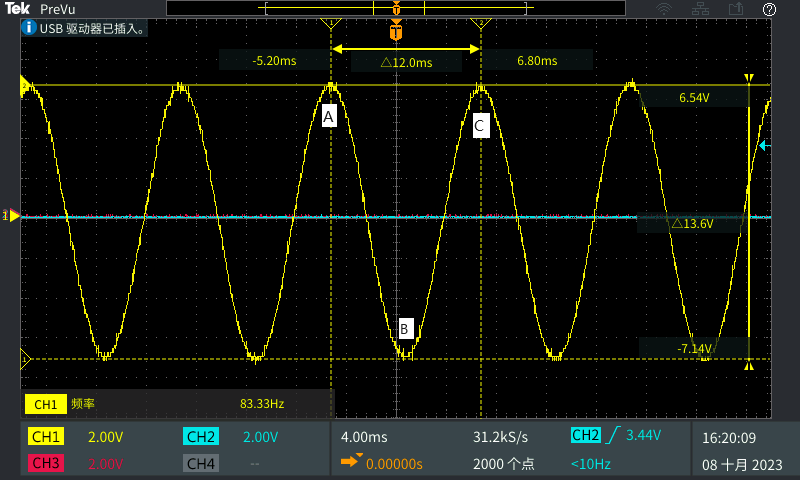

Below is my owm test.
Vpp=13.6v,pole pairs=5,fbemf=83.33Hz. Ke=(13.6*5*1000)/(2√2*83.33*60)=4.8085 Vrms/kRPM.
I wonder if I chose the wrong frequency?Is it between point A and point B or pointA and pointC?Thanks.
