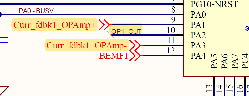

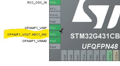

I want to read the current using single shunt method for stm32g431cb.I am not using SDK.Below is my Cubemx configuration.I am trying to read the opAMP out pin on adc via dma.
Tejashree
Below is my cubemx config:
0693W00000KZfSuQAL.png0693W00000KZfTYQA1.pngI am trying to Read OP1_out via ADC.
but I don't get any values when the motor is rotating.
can some help me to configure the pin for single shunt current read ?Also if there is any Opamp configuration
