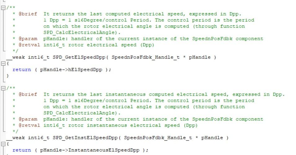

Hello everyone, How to get current speed of motor,useing speed_pos_fdbk.c ,i try to use the functions in fig2 SPD_GetElSpeedDpp but I don't Know how to get the control Period ,It is written in the comments to use the SPD_CalcElectricalAngle ,but i can't find it 。or is there another way to get current speed of motor。
Thank you very much

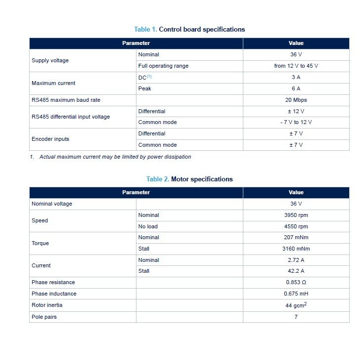

(fig1) motor Specification
(fig2)

We would like to sincerely apologize for the delay in replying to your post.
If your point is still relevant, all of the APIs are defined in the mc_api.[c,h] file.
To obtain the current average speed of the motor, use the following API: MC_GetMecSpeedAverageMotor1().
This API returns the most recent calculated average mechanical rotor speed, expressed in the unit specified by #SPEED_UNIT.
For instance, if RPM is the chosen unit, SPEED_UNIT should be defined as 60.
