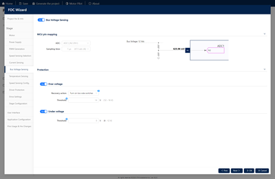

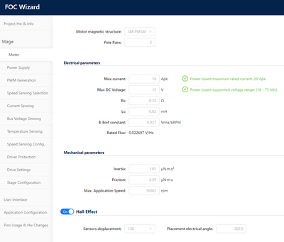

The application will be used for medical drills.
The type of motor is BLDC motor.
The following are the settings made through the motor pilot.
Regards
