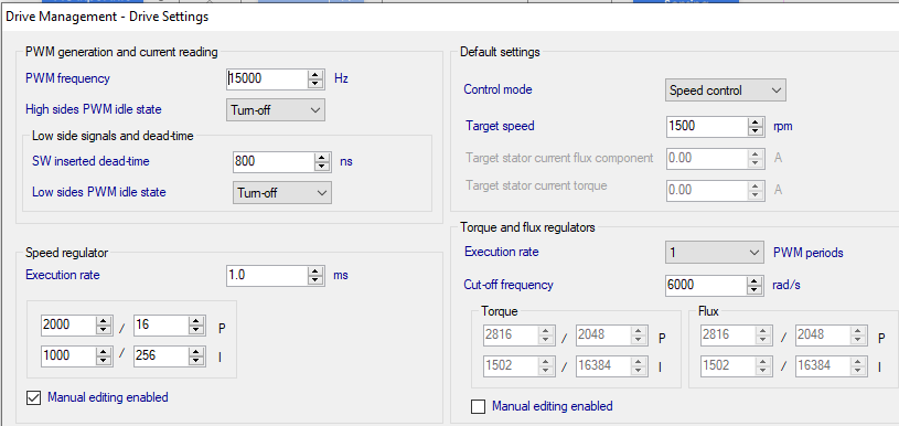

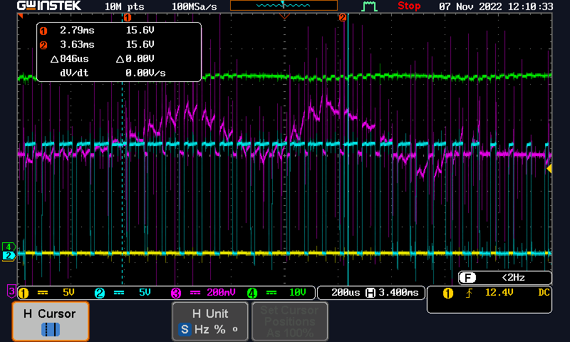

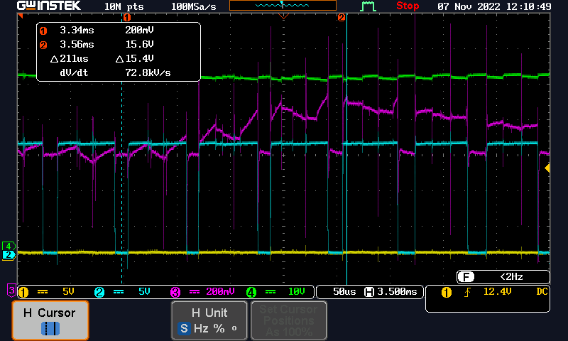

I am trying to find the cause for the MOSFET burning. Could it be caused by bad current and flux PI regulator settings? The settings I use are automatically calculated parameters from the workbench, I didnt tune them myself and they can be seen in the screenshot above. The motor runs smooth though. I can provide a current reading of one of the OPAMP outsputs from the current measurement during operation (pink color):
0693W00000WHyuaQAD.png0693W00000WHyv4QAD.pngINFO: the huge voltage spikes during switching are caused by long measurement wires and are not "real".
Could any other wrongly-set parameter cause excessive heating or switching losses of the FETs that could lead to mosfet burning ?
