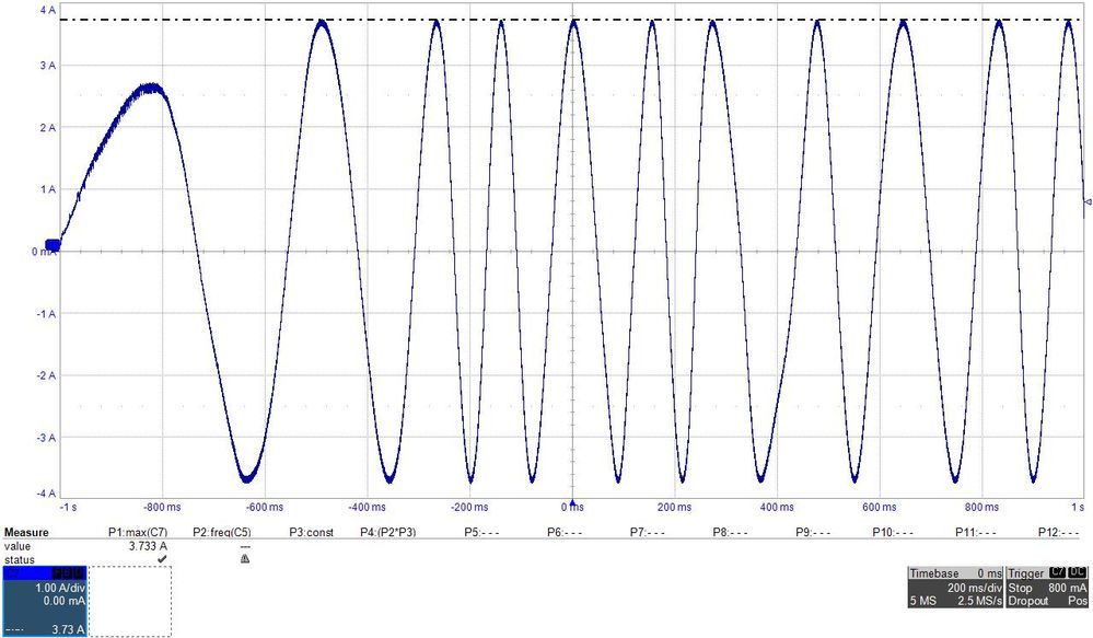

Gigi
​Whitout an HW modification what you can get maximum is 3.7A of phase current that you can get changing to 32182 the three define I mention in my firt post.
I tested this value and I didn't get over current, this will increase a little bit the provided torque.
The limitation in this case is in the maxium readable current of the board that is in the range of 3.7A. If you increse more probably you get the over current protection because the reading of the current will be saturated. You are providing more than nominal current of the motor but probably this condition can be sustanied temporarily by the motor. To increase more you have to modify the HW and in this case is better to switch to another board.
