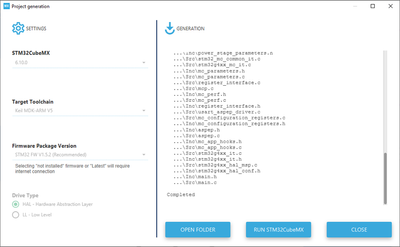

I'm using STM32G432RB Nucleo board with X-NUCLEO-IHM16M1, and connecting a 3-phase DCBL motor (RaceStart BR2205, which requests 7.4V - 14.8V).
Followed with the instructions in UM2415. I used a power supply with 12V/2A on X-NUCLEO-IHM16M1.
D1 EN/FAULT LED is always red, and D8/9/10, Motor Phase LEDs are never turned On, before or after I pressed the Blue Button (Start/Stop Motor) (on STM32G432RB Nucleo board).
Here is how I generated the code:
MC Workbench 6.3.0, FOC/3 Shunt
STM32CubeMX 6.10.0, STM32Cube FW_G4 V1.5.2
MDK-ARM V5.32
No error in each of these steps of the project and the code generation.
When I pressed the Blue Button (Start Motor) (on STM32G432RB Nucleo board), I saw PC13 (Start/Stop pin) generated a pulse.
Am I missing anything in the setup?
